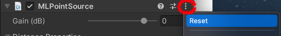

After updating the Soundfield plugin, if any unexpected/undesirable behaviors occur, it may be necessary to reset the Soundfield components. On simple objects, this can be accomplished with the three-dot menu in the Unity Inspector window for the Soundfield component.
  1. For each Soundfield component that needs to be reset, click the three-dot menu icon next its name in the Inspector window, then click Reset.
note
The reset should be performed on the MLListener component that is co-located with the Unity AudioListener, as well as the MLPointSource component.
Updating existing Soundfield version

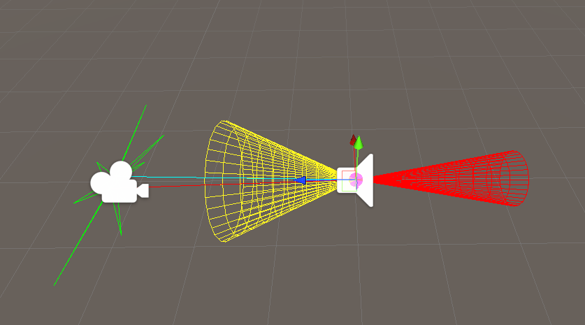

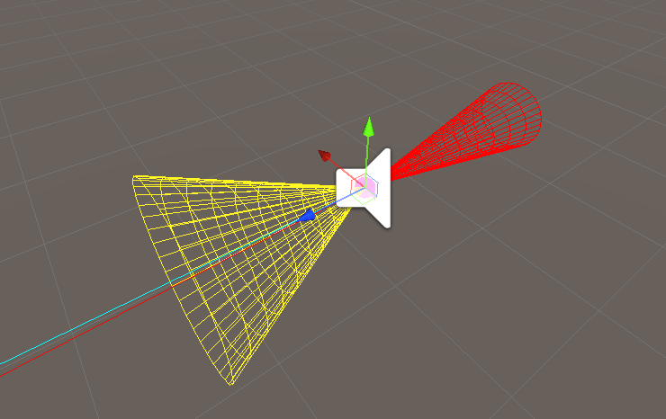

MLPointSource Gizmo Types​
Depending on the radiation properties, the point source Gizmo changes to indicate the current selection.
Full radiation​
ML Point Source component settings
Billboarding is enabled​
Omnidirectional is enabled​
